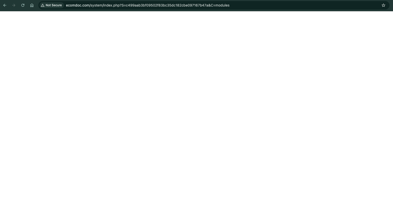

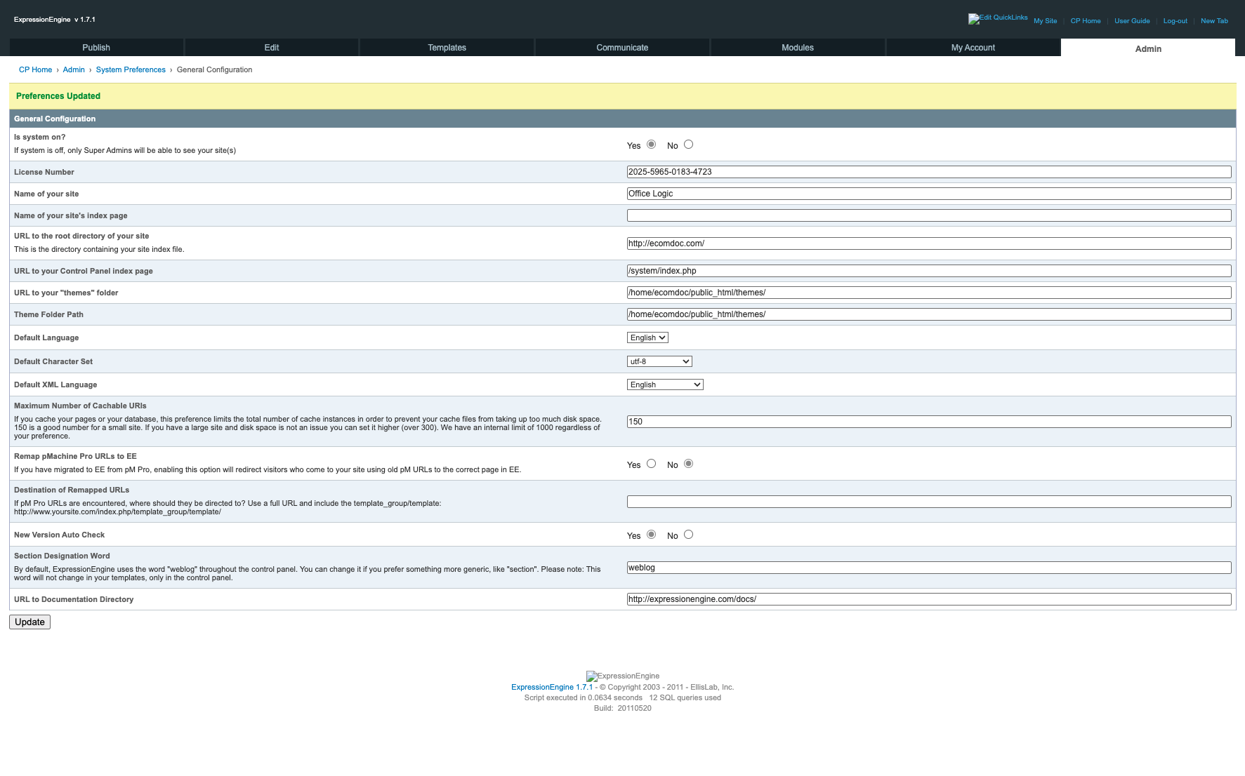

Hopefully someone can help me out. Have a very old EE 1.7.1 site that we migrated to a new server yesterday. It was a complicated setup but finally got it all sorted out and the site pulling up…for the most part. The big issue right now is that the backend of the website is not rendering, which I think is also leading to other issues on the site. I updated the config file and everything matches the old config file except the new names of the DB’s and the password for it. The site was migrated from ispmanager to cpanel. Obviously there is something, somewhere, that needs to be updated but I am not a developer so I don’t know where to go.

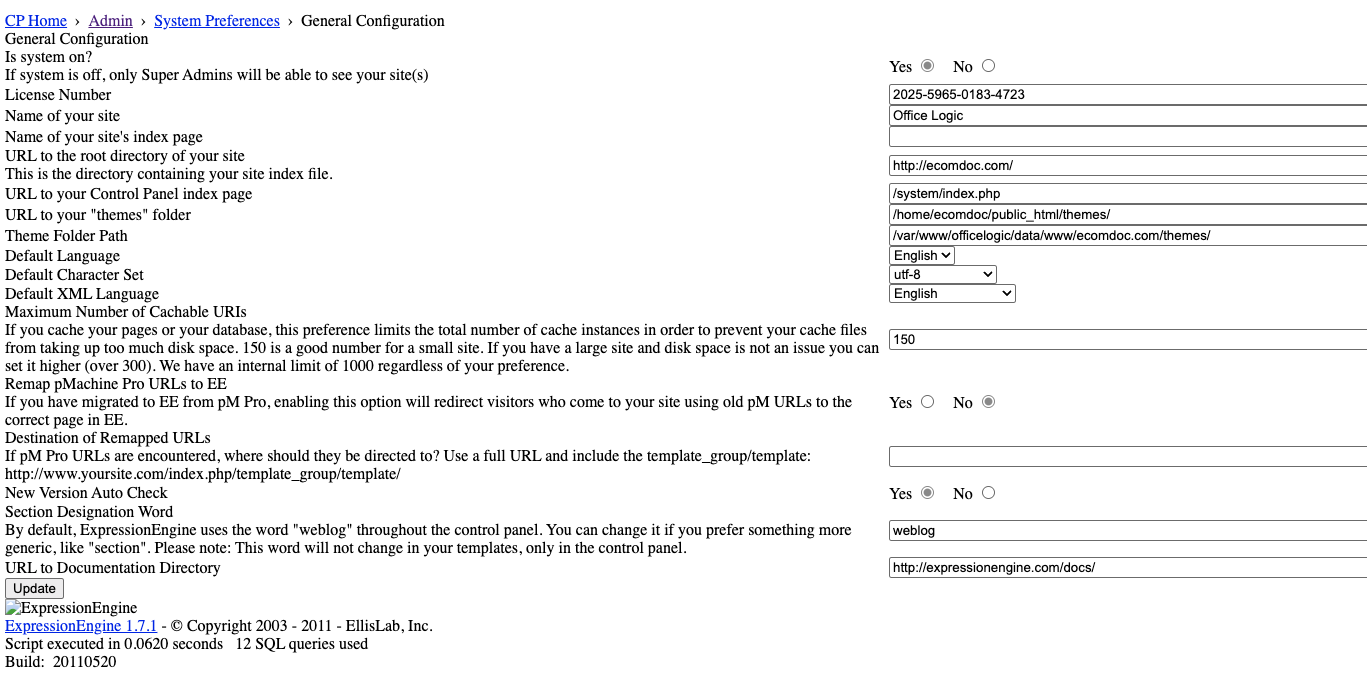

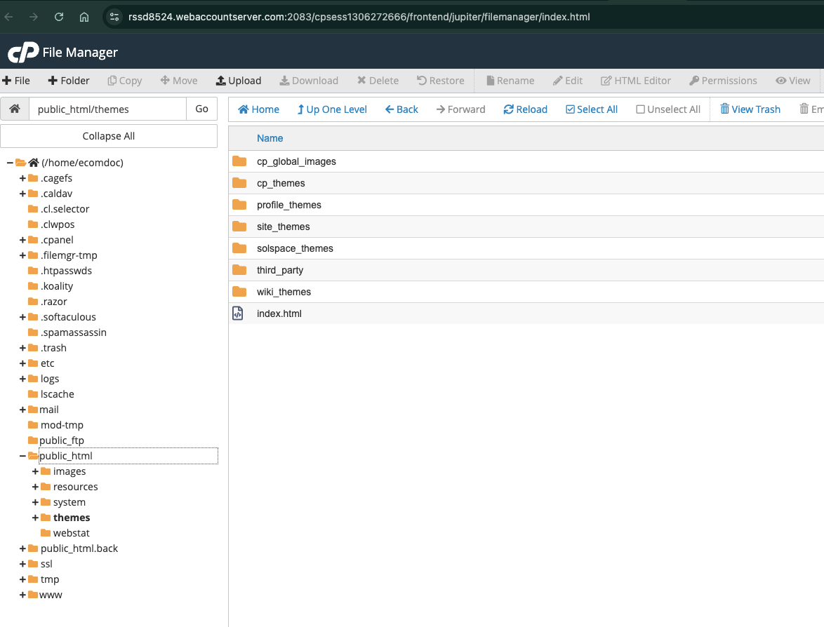

👆 Yes, check the path to the /themes folder as it looks like the CSS files aren’t loading.

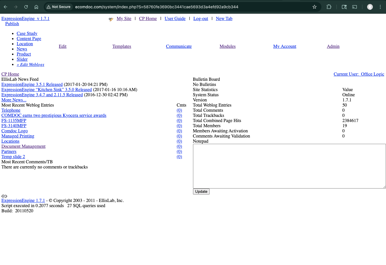

@dean where am I looking for that path at?
User tOKgLsjz's avatar
User tOKgLsjz
39 posts
one month ago
User tOKgLsjz's avatar User tOKgLsjz

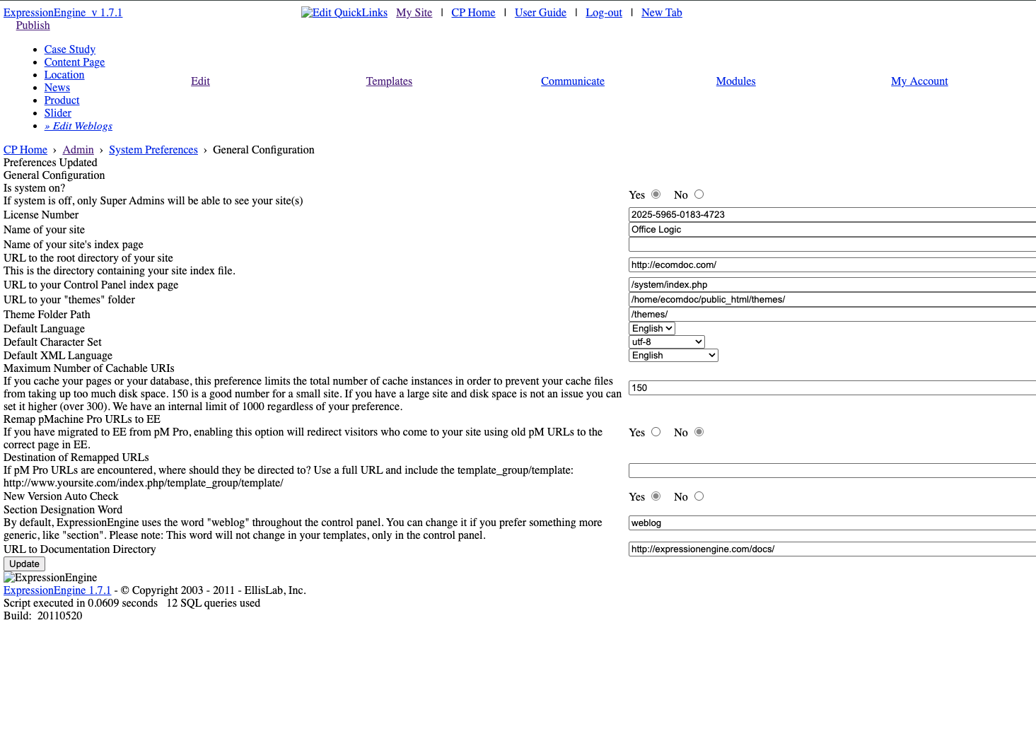

Yeah, this looks like a themes folder path issue. Those paths weren’t available as secret config values back then iirc, so you have to go to admin -> paths and fix it
User tOKgLsjz
39 posts
one month ago

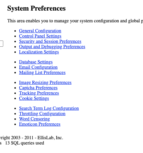

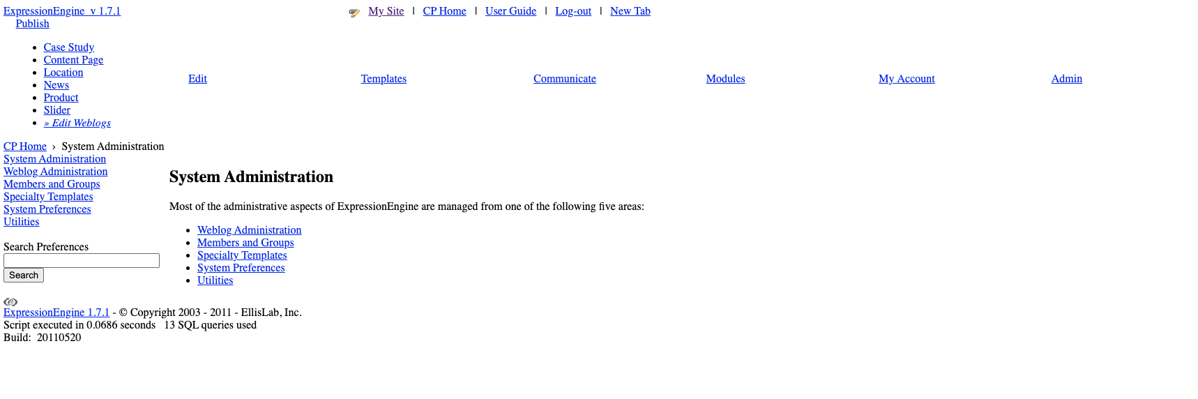

@Preston Feiler click on Admin at the top, i don’t remember what the submenu items are so send a screencap and i can tell you which one it will be
