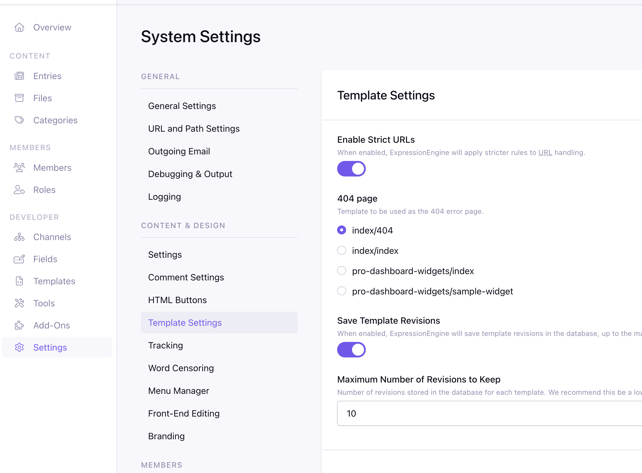

Hello,
I have a default template group index with index and 404 templates inside. Strict URLs is enabled, 404 page is point to index/404.
If I enter any random page, like: /hello-world it will render:
$ curl 'http://localhost:8080/hello-world' -I
HTTP/1.1 200 OK
What I expect is that it will show index/404 template with 404 http status. How to do this? Please help

Houdini's avatar Houdini
Thanks for your reply. I agree with you.
But I didn’t get about server configuration — to me it does not and can’t affect 404 status. I think it’s something inside CMS settings, but the only CMS settings I found is Template Settings
I found the reason. In my case I didn’t specify nginx fastcgi_param SCRIPT_NAME directive. My problem solved. Thanks
