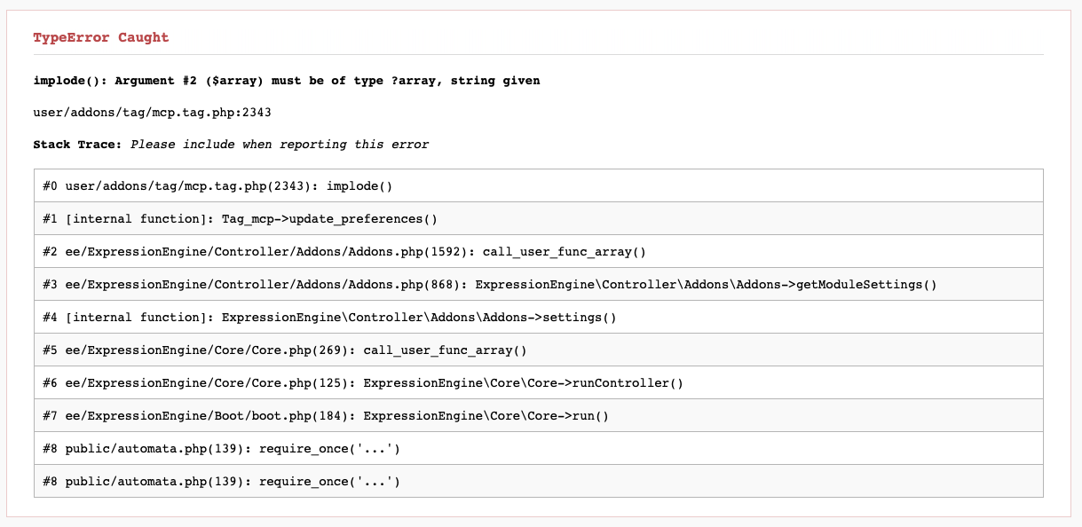

I have EE 7.5.7 running on a site with PHP 8.3. I added the Tag add-on, which works, but I cannot update it’s preferences. I think I have the latest version of tag which is 7.3.1.
TypeError Caught
implode(): Argument #2 ($array) must be of type ?array, string given
user/addons/tag/mcp.tag.php:2343
Stack Trace: Please include when reporting this error
#0 user/addons/tag/mcp.tag.php(2343): implode()
#1 [internal function]: Tag_mcp->update_preferences()
#2 ee/ExpressionEngine/Controller/Addons/Addons.php(1592): call_user_func_array()
#3 ee/ExpressionEngine/Controller/Addons/Addons.php(868): ExpressionEngine\Controller\Addons\Addons->getModuleSettings()
#4 [internal function]: ExpressionEngine\Controller\Addons\Addons->settings()
#5 ee/ExpressionEngine/Core/Core.php(269): call_user_func_array()
#6 ee/ExpressionEngine/Core/Core.php(125): ExpressionEngine\Core\Core->runController()
#7 ee/ExpressionEngine/Boot/boot.php(184): ExpressionEngine\Core\Core->run()
#8 public/automata.php(139): require_once('...')
Any insight is greatly appreciated.

Thanks for posting this. We just pushed an update that will fix this!
If you could test and confirm it’s working as intended it would be SUPER awesome!

Confirming that you fixed my problem. Great work! Thanks for your help.
