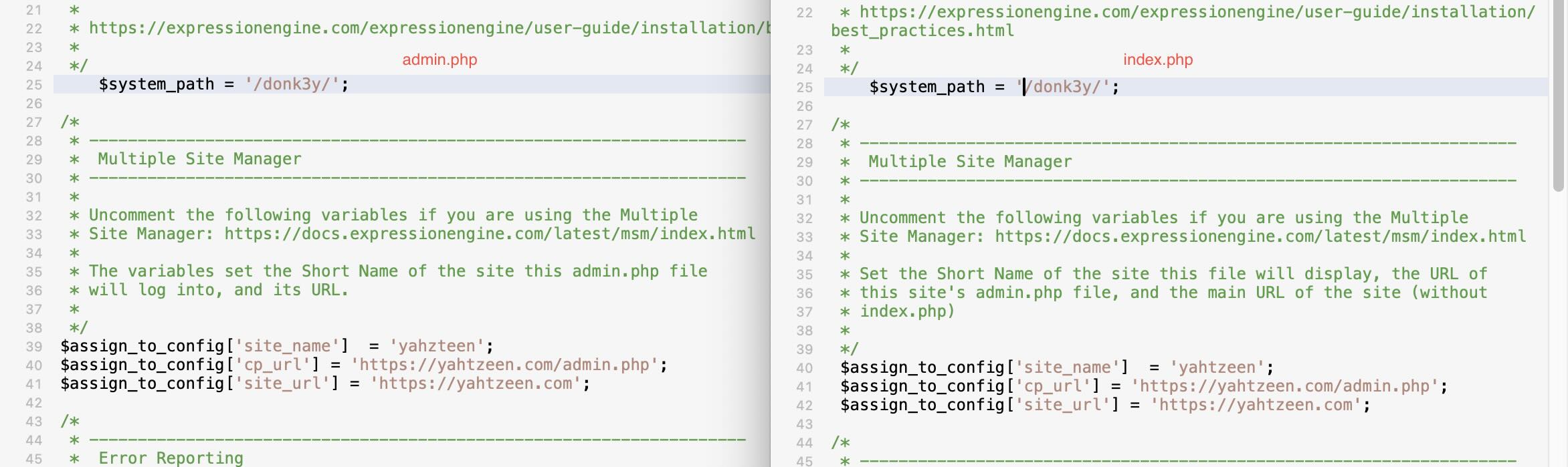

getting this message when I try to login to the cp: Your system folder path does not appear to be set correctly. Please open the following file and correct this: admin.php
yahtzeen.com is the main site
ralphscorner.com is second msm site

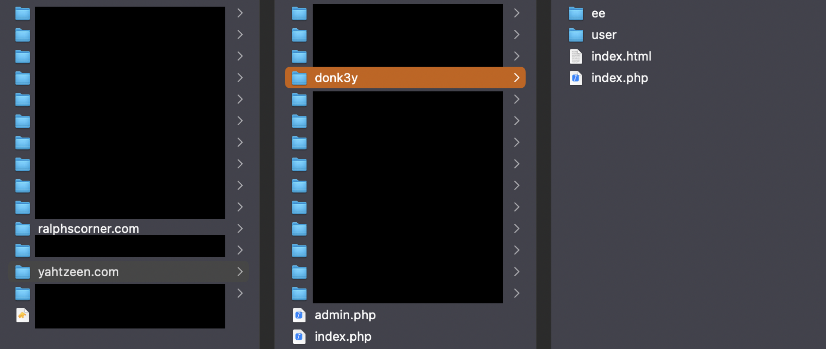

donk3y is the system folder
previous to the upgrade the CP was working fine but yahtzeen.com was not viewable. ralphscorner.com was working fine.
so in my infinite wisdom I thought “oh I should upgrade my EE install”.
attached is the index and admin files of the yahtzeen.com directory and the directory structure.
am I overlooking a simple mistake or did I totally destroy my sites?

Can you try changing your system_path in index.php and admin.php to
$system_path = './donk3y';
I think that should work

It’s trying to query the exp_sites table and pull back the preferrences for the correct site. If you have a site name set- check your index.php page your admin.php page and your config.php - it’s going to use that. Look in your database- do you have that all matched up? If you don’t have a site name, it’s going to default to site_id 1. Try and sort that out.
