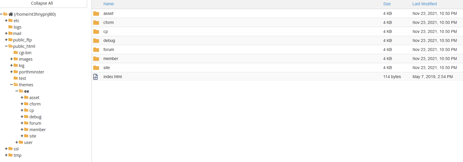

Does /var/sites/k/mywebsite.co.uk/public_html/themes/ee/ exist on your server? Sounds like something has changed in your file structure. If so, you may also need to go change the paths to your upload directories as well.

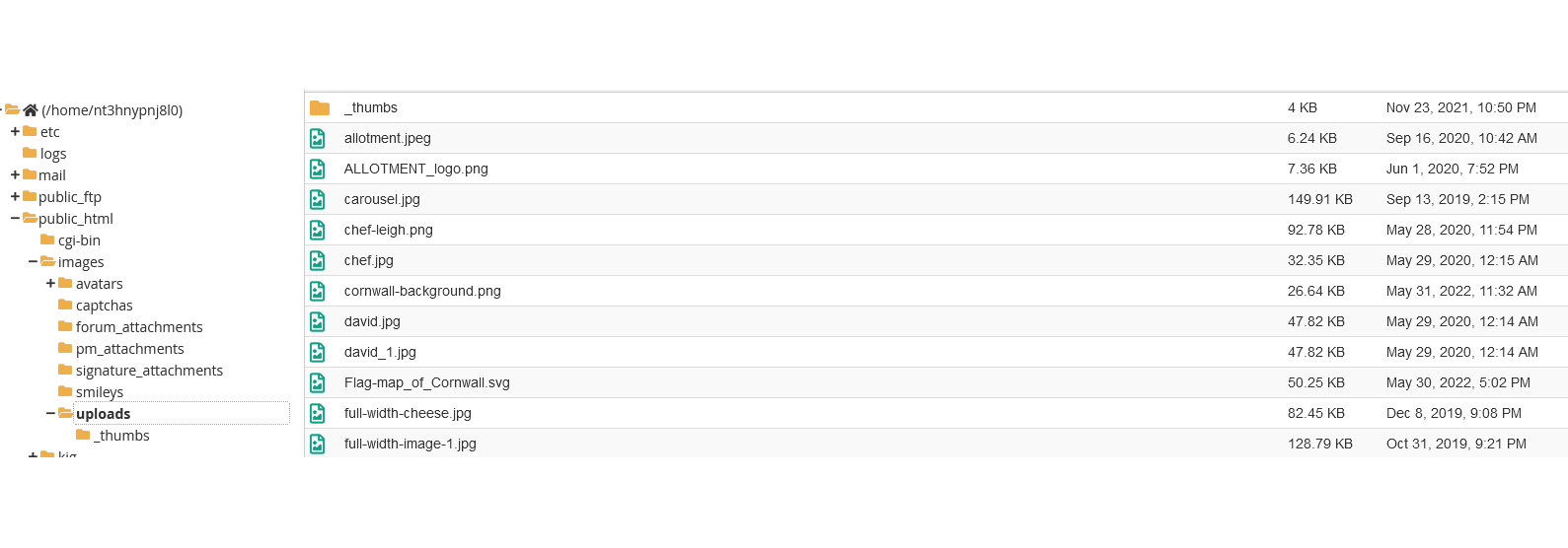

Here’s the file stucture on the server and a view of the image uploads folder… it looks right to me but clearly something isn’t matching up!
The images for example are all published at the URLs you’d expect!
Any tips would be much appreciated!
