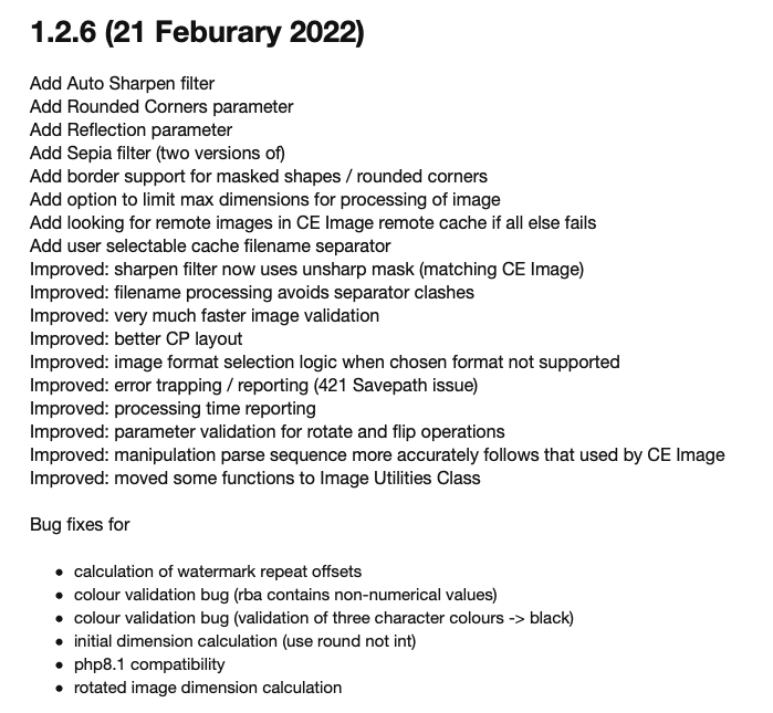

Here is a block of text from the Readme.md file associated with JCOGS Image.
### 1.2.6 (21 Feburary 2022)
Add Auto Sharpen filter
Add Rounded Corners parameter
Add Reflection parameter
Add Sepia filter (two versions of)
Add border support for masked shapes / rounded corners
Add option to limit max dimensions for processing of image
Add looking for remote images in CE Image remote cache if all else fails
Add user selectable cache filename separator
Improved: sharpen filter now uses unsharp mask (matching CE Image)
Improved: filename processing avoids separator clashes
Improved: very much faster image validation
Improved: better CP layout
Improved: image format selection logic when chosen format not supported
Improved: error trapping / reporting (421 Savepath issue)
Improved: processing time reporting
Improved: parameter validation for rotate and flip operations
Improved: manipulation parse sequence more accurately follows that used by CE Image
Improved: moved some functions to Image Utilities Class
Bug fixes for
- calculation of watermark repeat offsets
- colour validation bug (rba contains non-numerical values)
- colour validation bug (validation of three character colours -> black)
- initial dimension calculation (use round not int)
- php8.1 compatibility
- rotated image dimension calculation
If I render this using either EE’s internal markdown service or the markdown preview in VSCode I get this…
Add Auto Sharpen filter Add Rounded Corners parameter Add Reflection parameter Add Sepia filter (two versions of) Add border support for masked shapes / rounded corners Add option to limit max dimensions for processing of image Add looking for remote images in CE Image remote cache if all else fails Add user selectable cache filename separator Improved: sharpen filter now uses unsharp mask (matching CE Image) Improved: filename processing avoids separator clashes Improved: very much faster image validation Improved: better CP layout Improved: image format selection logic when chosen format not supported Improved: error trapping / reporting (421 Savepath issue) Improved: processing time reporting Improved: parameter validation for rotate and flip operations Improved: manipulation parse sequence more accurately follows that used by CE Image Improved: moved some functions to Image Utilities Class
Bug fixes for
The same text rendered using the Marked 2 app on macOS comes up as shown in the attached image.
The VSCode version is the ‘correct’ markdown rendering… Marked 2 only generates the text with lines because it has a default option to ‘retain line breaks within paragraphs’ - if I uncheck this I get the same output from Marked 2 as from the VSCode preview.
If what you want is a similar option added to EE’s markdown processing then put in a feature request … but in the interim I think you just have to accept that what EE is doing is what it should…
HTH
