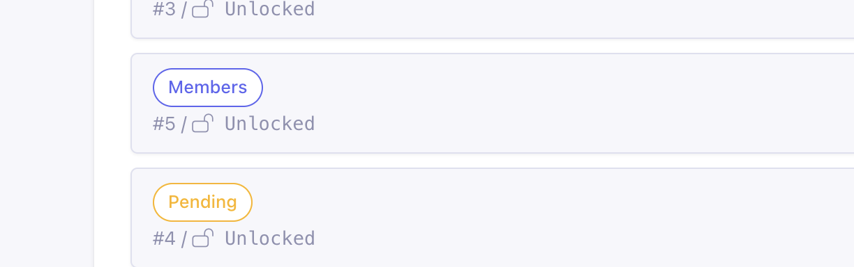

The forum is definitely free, so that shouldn’t be in play on the latest EE.
But I think that message is a hint- go look in ‘Members- Roles’ and make sure both pending and members are unlocked- see below.
There are alot of permissions associated with frontend member sign-ups. So you have to allow them, and you need to decide if it’s automatic or if they have to do email verification or manual verification and such. But if you get those right and unlock the role, it should work.
If it still gives you any trouble, let me know and I’ll test it out.

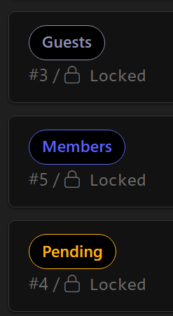

Thanx Robin.
In my admin all roles are Locked except Admin
Any clue?

OK Robin I just found Security Lock. hahaha my mistake mate.
Once more thank you and all the others for trying to help.
I will come back with news about it.
LOL, no worries- glad you found it. Let us know if that fixed it!
Yianniotis's avatar
Yianniotis
7 posts
Yianniotis's avatar Yianniotis
OK Robin that fixed it. Thanx again.
