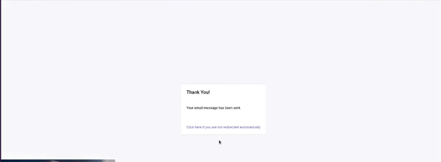

I was testing ExpressionEngine long time ago and there’s one thing I do not like. I believe it’s called “Message templates”.
Is it possible to create ajax messages?
For example: When I fill out contact form and click submit, a success message above contact form would appear?

  • “redirect=”none” bypasses the System default message (which you posted an image of)
